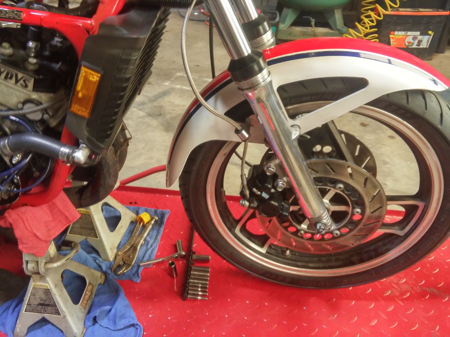

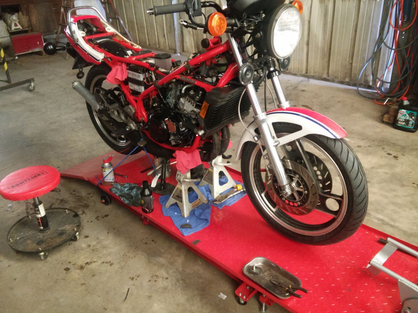

Front wheel installed. All that is left is:
Build and install front calipers and new master cylinder. Bleed brakes. Install gas tank, side covers and seat. Adjust chain and test ride :D :D
PostPosted: Thu Nov 26, 2015 2:44 pm

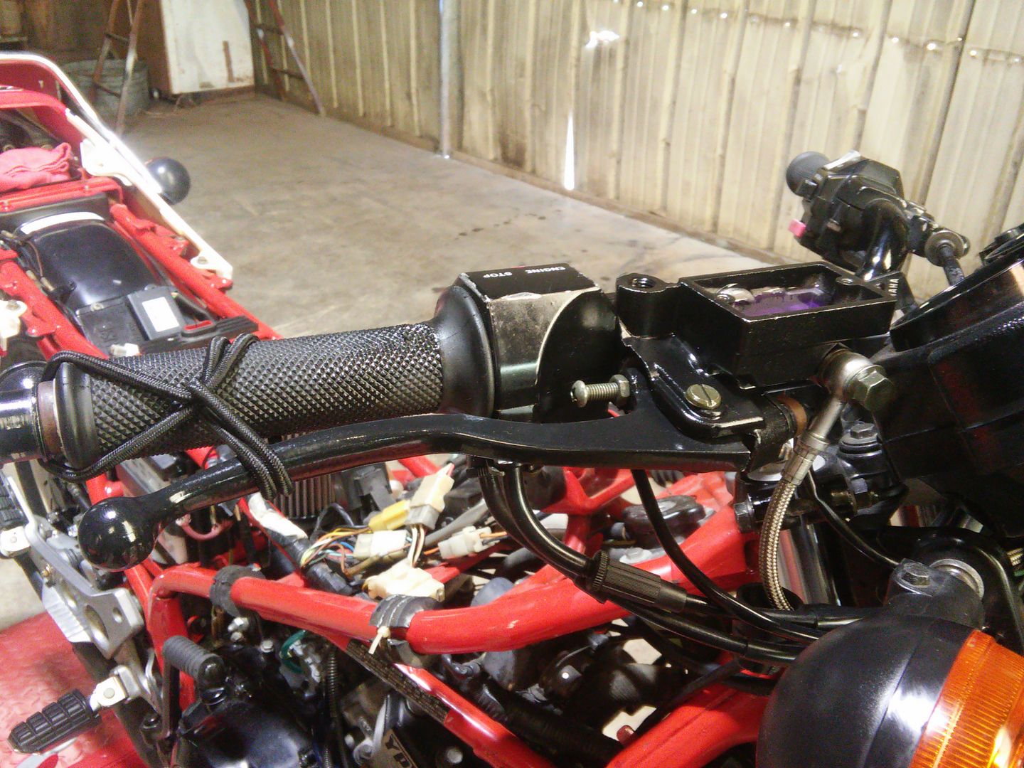

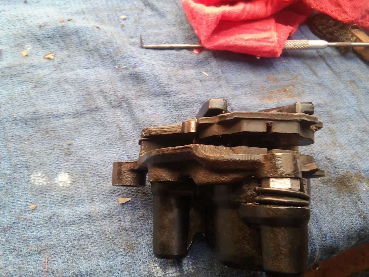

Since I had to work today and any Thanksgiving festivities will be taking place at work, I finished up the brakes. Calipers cleaned, bead blasted, painted and built.
New ebay master cylinder fit perfect. Initial bleeding was routine with the trusty Mity-Vac. Lever tied to bars to burp last of air out. No leaks and no dragging. Tomorrow I will put the tank back on, check tighten all bolts, scrub the mold grease off the new Avons and ride.....

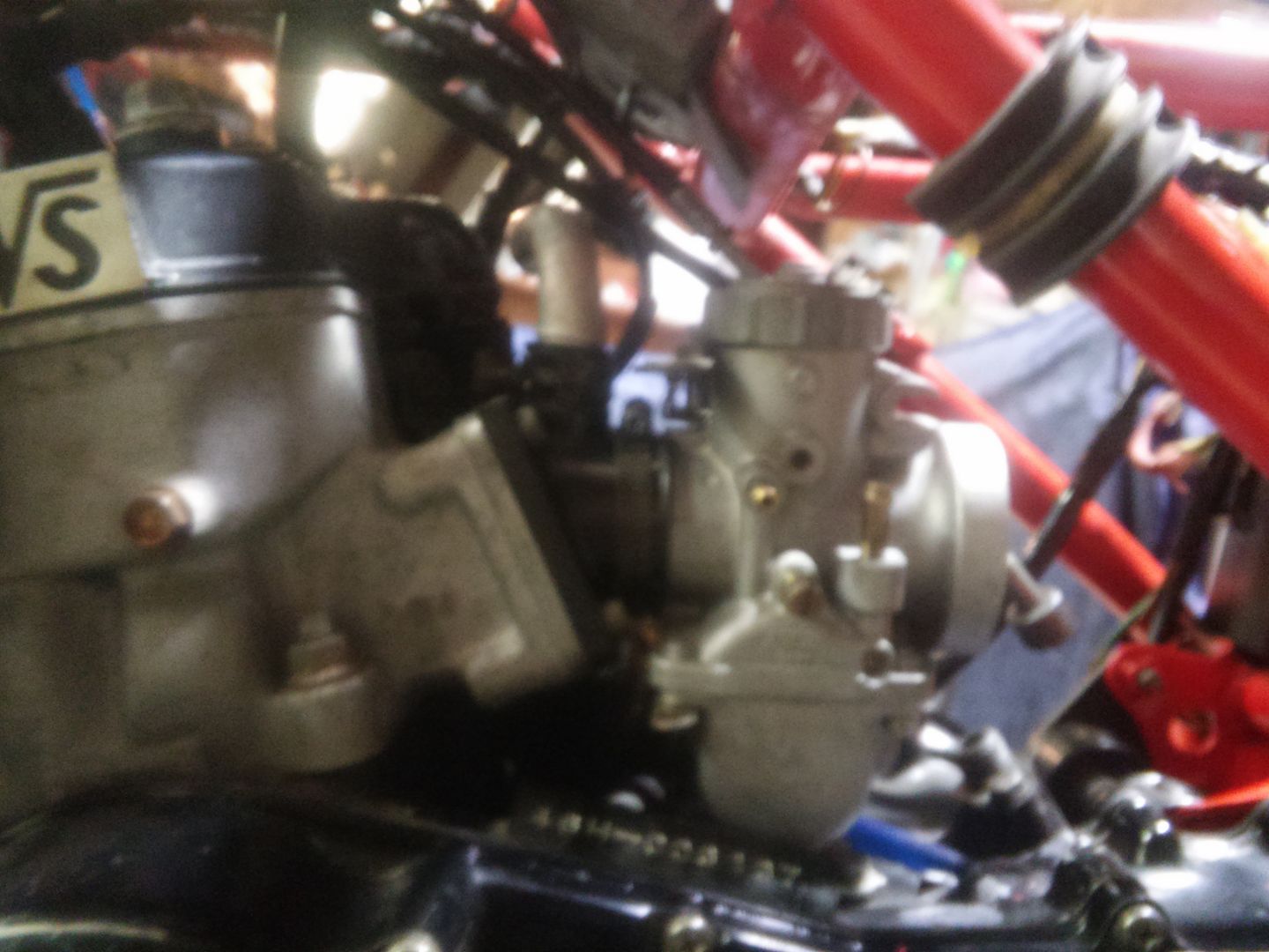

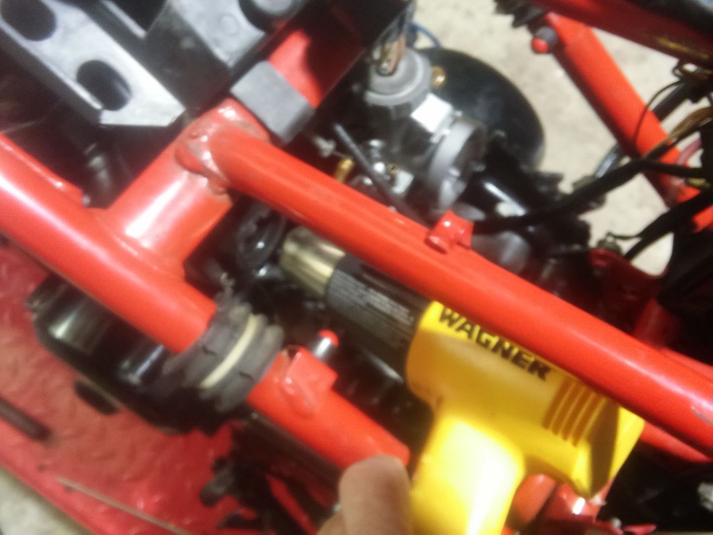

The VM 30 install commences, 1st we warm things up a bit and add a dribble of PB Blaster to ease them in.Image
PostPosted: Wed Dec 02, 2015 4:16 pm
A view of the 30s from above:Image
PostPosted: Wed Dec 02, 2015 4:18 pm

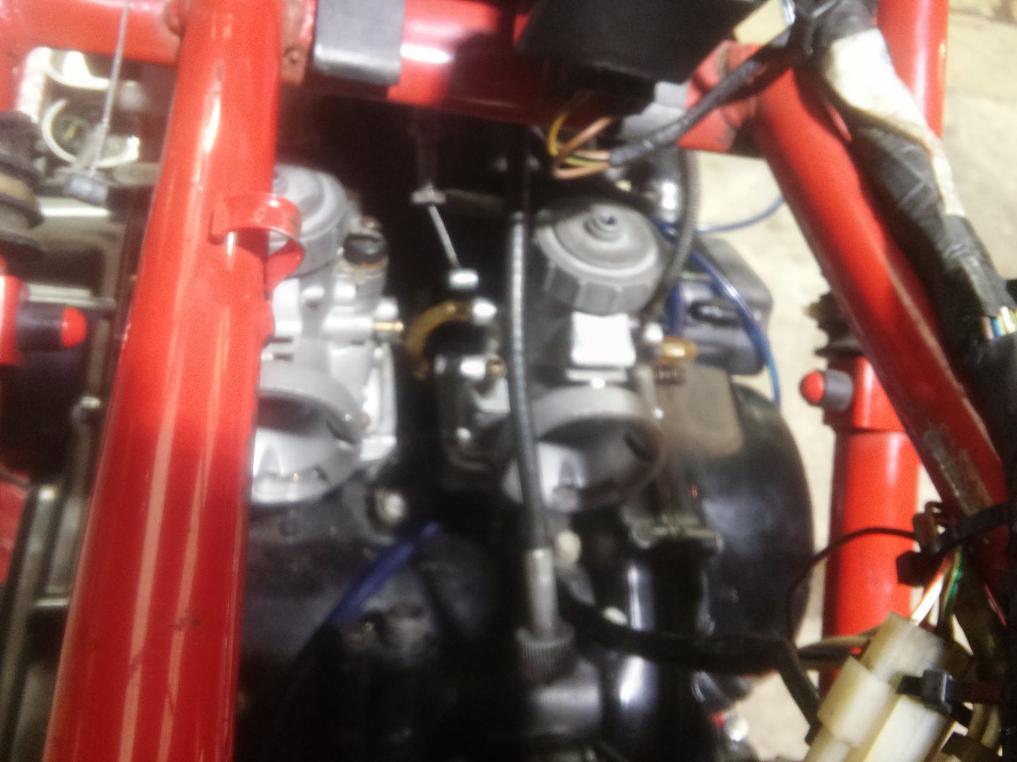

A bit of ball peen and a dash of channel locks and the clutch linkage and arm just barely clear the carb. They sure fill up the space. The carbs are fitted with oil nozzles and a vacuum port. Next up is the custom throttle and oil pump cable install and rig.
