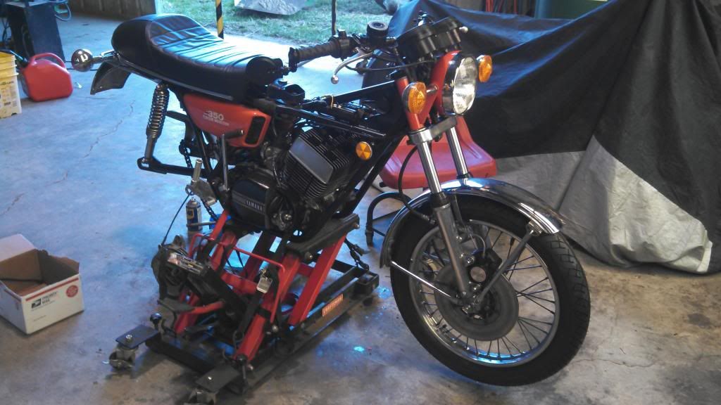

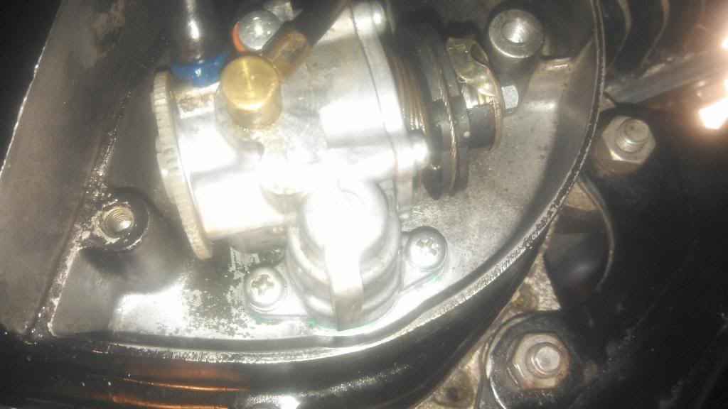

Resealed oil pump and clutch cover reinstalled, hopefully I will find no leaks in the AM, when work will continue. I also hooked up the new oil tank feed line and bled the pump.
Refilling the trans and oil tank: BTW that is Blue Marble in the Mobil 1 bottle

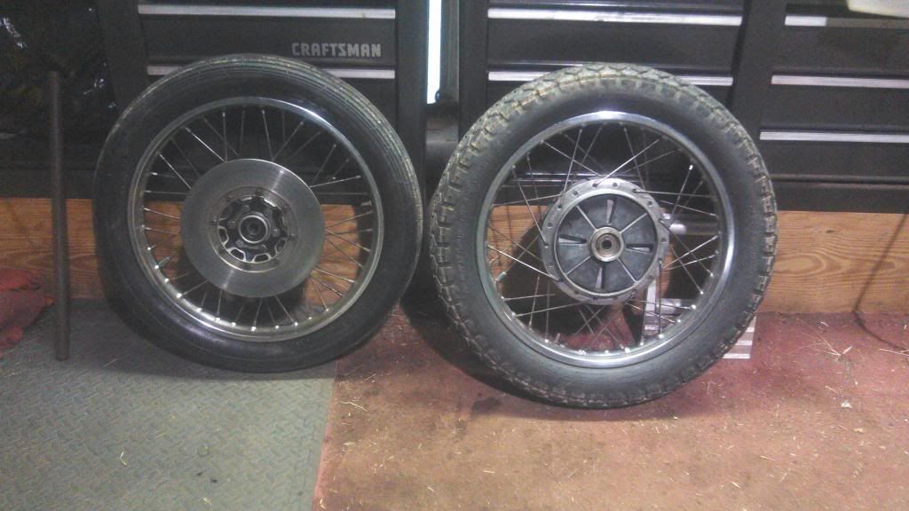

Both wheels off, spokes cleaned as good as they are gonna get:

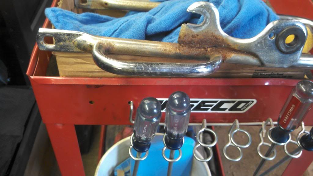

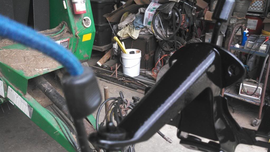

Grab rail/ rear turnsignal bracket removed:
Cleaned, polished and reinstalled:

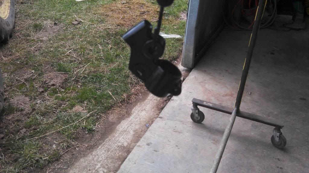

Tailight bracket beadblasted and painted with Rustoleum semi-gloss black;
Clutch perch beadblasted and painted:

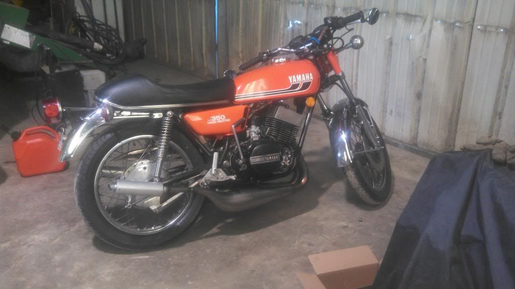

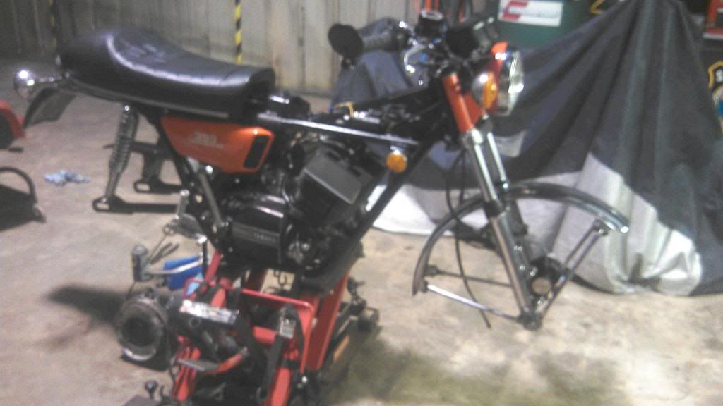

Yeaterday was a good shop day:
Chain and sprockets arrived at 1200 hrs I assembled everything and ran it down the road at 1700. I added 1 oz of oil to the forks per the Haase to stop the front end dive and firm things up a bit. The Girly Bike is a pleasure to ride with the new BT45s, handling is superb. Wheelies were pulled.. effortlessly :D :D . Tach from parts bike installed as the original has died an untimely death. I pinched the ground side of the neutral light wire installing the tach and had to abort the maiden voyage when I realized the neutral light wouldn't go out. So back to the shop I went to pull the tach off and I taped up the nick in the ground wire. I love the Moto Carrerra chambers. Carburetion is linear and at 7000 things start happening quick. 9000 is the shift point. 15/39 gearing is perfect for this combination. I only have a couple of small issues to deal with and Project RD will be ready for DG 13 :D :D I installed the LH chamber spacers wrong and the sidestand is striking the chamber. I also have to clean it up and again and install the oil pump and clutch adjuster covers. The new oring chain will need an adjustment as well. Forgot to add I have to replace all the seals in the gas cap...I have the parts.
