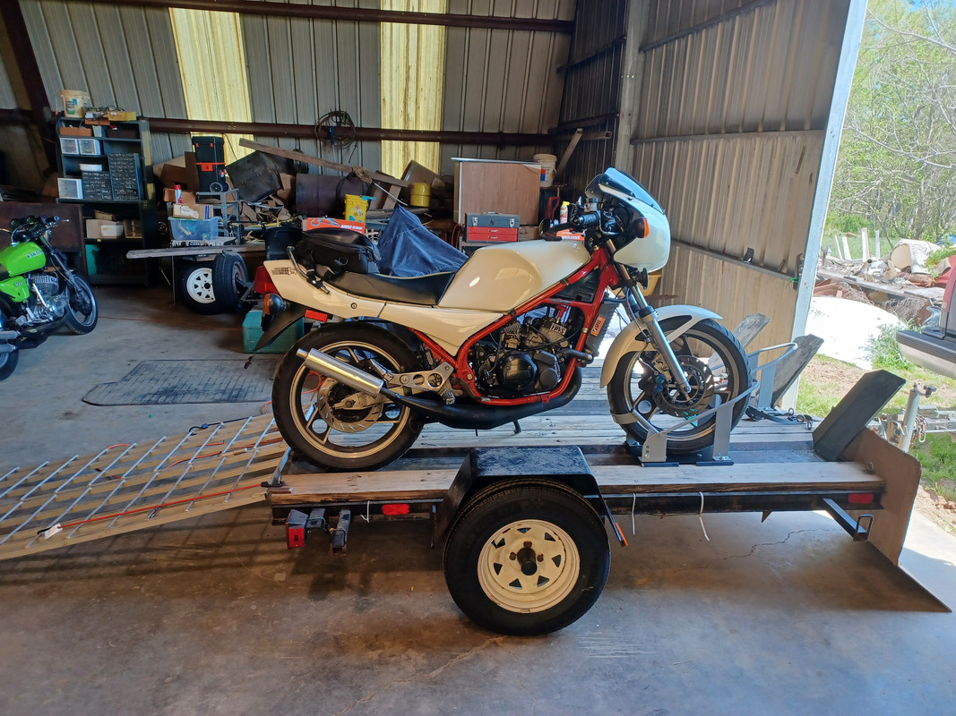

Physics has intervened on my behalf, thanks to M in SC for the warning and advice. I loaded two bikes into the chocks I had and the 3rd one I loaded and placed onto the trailer in the place where the 3rd chock would go. I discovered that the load was too far aft. About 50 pounds of force enabled me to pick up the tongue and take the pressure off the hitch ball. With about 1100 pounds on I shouldn't be able to budge the tongue. That is very dangerous. I hadn't drilled the 3rd chock yet thank God so I only have to re-drill 4 holes to move the right hand chock up and then 4 more holes to mount the last one. I knew the potential for this existed was hoping I could get away with it but the possibility of a severe swaying incident isn't worth it. I can back the RD in and put the other two on the outside. Oh well, I tried... :banghead :e4 :e4

Yeah I had to offset them back 22 inches to get the spacing needed to keep them from touching and that proved to be too far. Mark saw it in a picture and cautioned me. When I was able to lift it up that easy with that load it concerned me. So on we go...

Pretty well done now.
PostPosted: Sat Apr 30, 2022 10:28 pm
Posts: 10014
Is the interference a non-problem? It looks good.
The ones I bolted in my van look like they're the same, but they're bumble-bee colored... yellow and black.
PostPosted: Sun May 01, 2022 8:06 am
The only problem is you have to back one bike in and push the other two on. Makes it hard to do by yourself. Unloading is easy.
