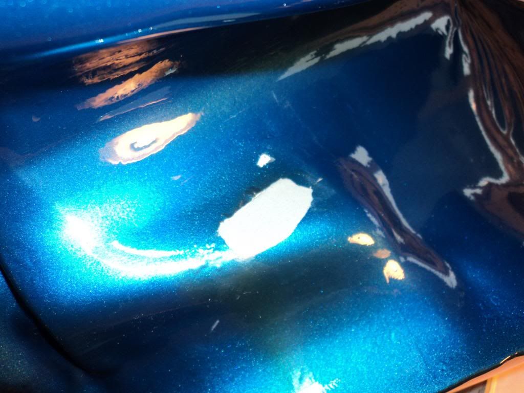

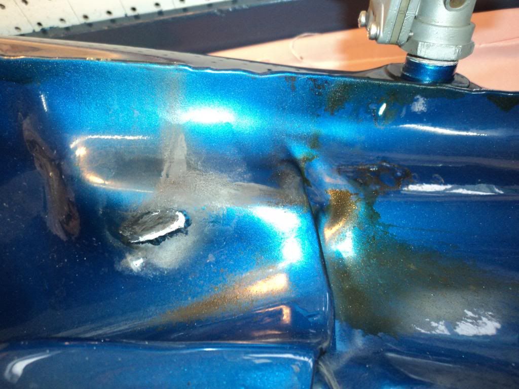

Please check under your tank. I got a hole in my tank from the metal clutch cable adjustment ( in the middle of the cable) rubbing and or sandwiched in between the tank and the frame. I must not have noted the last time I installed the tank. Do not let this happen to you. Check it.
Patch with JB Weld.

you can seal that up with some caswell w/out a repaint or a tank strip. good thing you caught it. would hate to see a fireball from the south from OL PODNAH going KABOOM!

Nice patch son.
How much gas leaked out before you noticed?
Glad you didn't go KABOOM like the guys said.

What is Caswell? I have a small hole from the throttle or choke cable and I used Seal-All. I don't trust it and I'm thinking I should have used JB Weld or something else.

Caswell makes a tank sealer called Phenol Novolac that has proven to be a very good product. I'm sure it would patch a hole fine, but it's sold in a quantity large enough to coat the inside of a tank.

Over 10 years ago, my VF500 started weeping fuel from a rust-through spot. A "temporary" repair with J-B held for over 5 years. May still be holding, but I bought a replacement tank so can't say for sure about the repair lasting beyond that.
