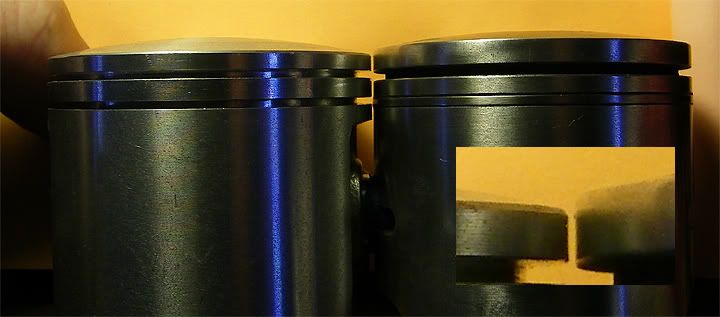

Here is the "poop" on the RIK/Mitaka pistons. I just got a set in from Reproductiondecals, first over 400.
They came with Riken rings.
The wrist pin is 14 mm instead of the stock 15, but comes with a bearing to make up the difference.
The clips are a strange "G" type.
I haven't checked the rings in the grooves yet.
No directional arrow
The piston edge is approximately 1mm lower than stock.
This takes the compression from 6.5:1 to 6.32:1
Compression goes from stock 143 to 139psi
This adds about 4.4 degrees to the exhaust timing
It adds about 5.5 degrees to the transfer timing

There are cheap Honda pistons on e-Bay that also have that type of clip. They should be easier to install...
Trevor
