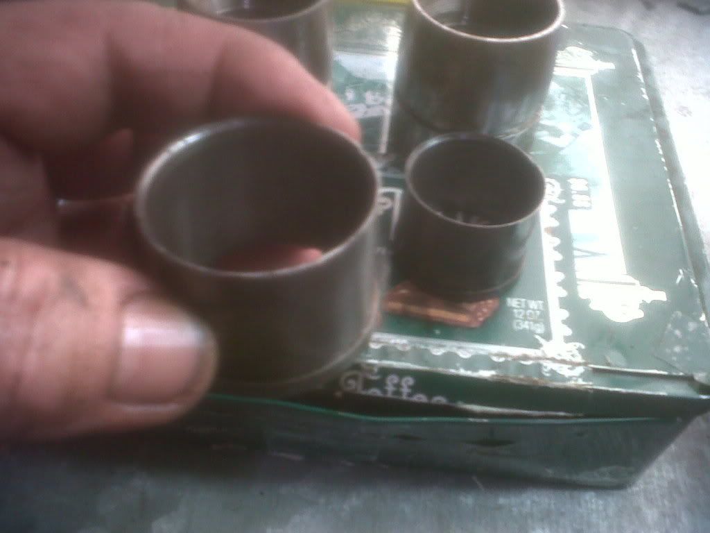

PostPosted: Fri Jan 27, 2012 8:56 pm
Joe,
I got em out. The fork tubes were froze in the triple trees. I had to impact the top cap bolt offs. Then I had to beat them out of the trees :D :D :D
My Bride and I were not on the best of terms so the 2 hours of beating and cussing did me a lot of good. :banghead :banghead :banghead .
They aren't perfect as they came off the rusty tubes hard. But the bike only had 5K on it and they fit a non rusty section of the tubes perfectly with no slop. I will send the bushings and the caps. Do you need anything else?
