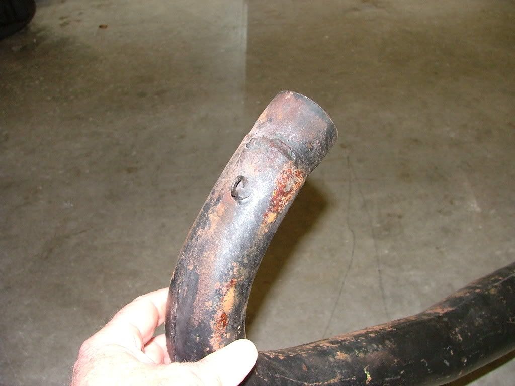

I would clean out the end of the pipes with a wire brush / Dremmel and lube them up with some silicone grease, they're a tight fit! :shock: If they don't leak (we need a "fingers crossed" smiley) I may make a few sets, I have some ideas for some improvements too... :think:

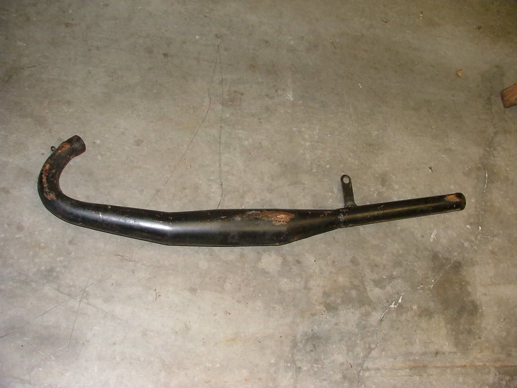

The manifolds are from Redline. They didn't quite fit the pipes so Bill turned them down and had the idea of machining in the o-ring grooves to help seal them to the pipes. I got the Spec2's off eBay (with no manifolds) some time ago for a H2C project that I will be shipping off to Brian soon. :thumbup: These should work MUCH better than Spec2 manifolds...and look cooler too! :ugeek:
