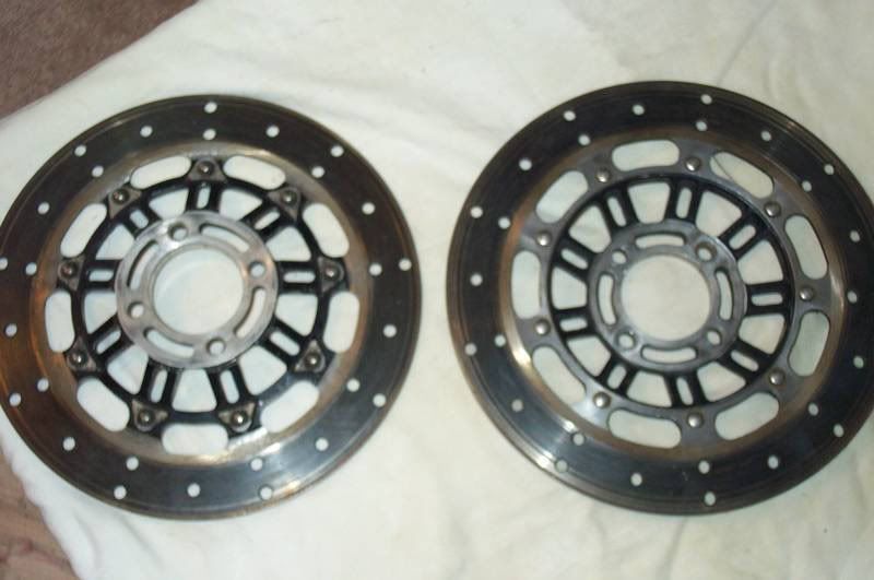

Hmmm. I like these, but the guy wants $175 for the pair....

PostPosted: Wed Jan 11, 2012 8:43 pm
wow... I just realized those are factory discs! That looks like $175.00 worth of work to me all day long. I wonder what they weigh? :lol:
PostPosted: Wed Jan 11, 2012 9:00 pm
They look a bit scary to me, but I guess using duals would cut the load in half.
PostPosted: Wed Jan 11, 2012 9:11 pm
It's interesting to see how "flimsy" modern sports-bike rotors are, and they have a lot more work to do..............! (Granted, they are duals.)
