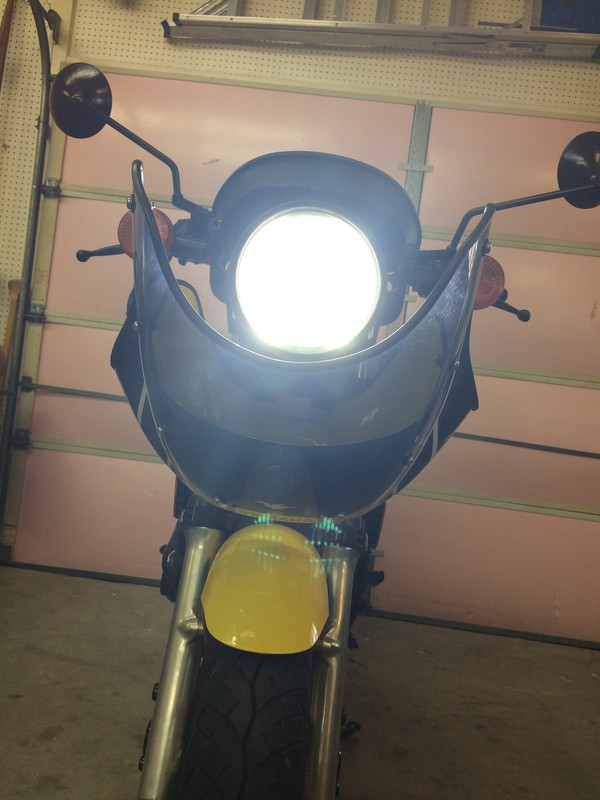

Now the BULB only will also change out with the bulb in the RZ 350. Talk about a difference.
Inside bucket you will need if you don't have an H4 connector 3 prong female plug.
I have a picture of High and Low beam from the RZ that I changed just the Bulb. I could sent to someone if they want to attach it to this post.

Here is the picture.
PostPosted: Mon Aug 12, 2019 9:53 am
Posts: 10015
From Iron, new LED bulb installed in his RZ350

I'm sure it will be manageable, but do you know what the draw might be? I'm sure it will be lower than the incandescent candle we currently have on H2's
PostPosted: Mon Aug 12, 2019 11:44 am
Wattage
16W
Voltage
DC 7.3V – 24V Full Brightness, DC6.3V -7.2V 60% Brightness
PostPosted: Mon Aug 12, 2019 11:48 am
That's a nicer pattern than my Nighthawk (TruckLite).
