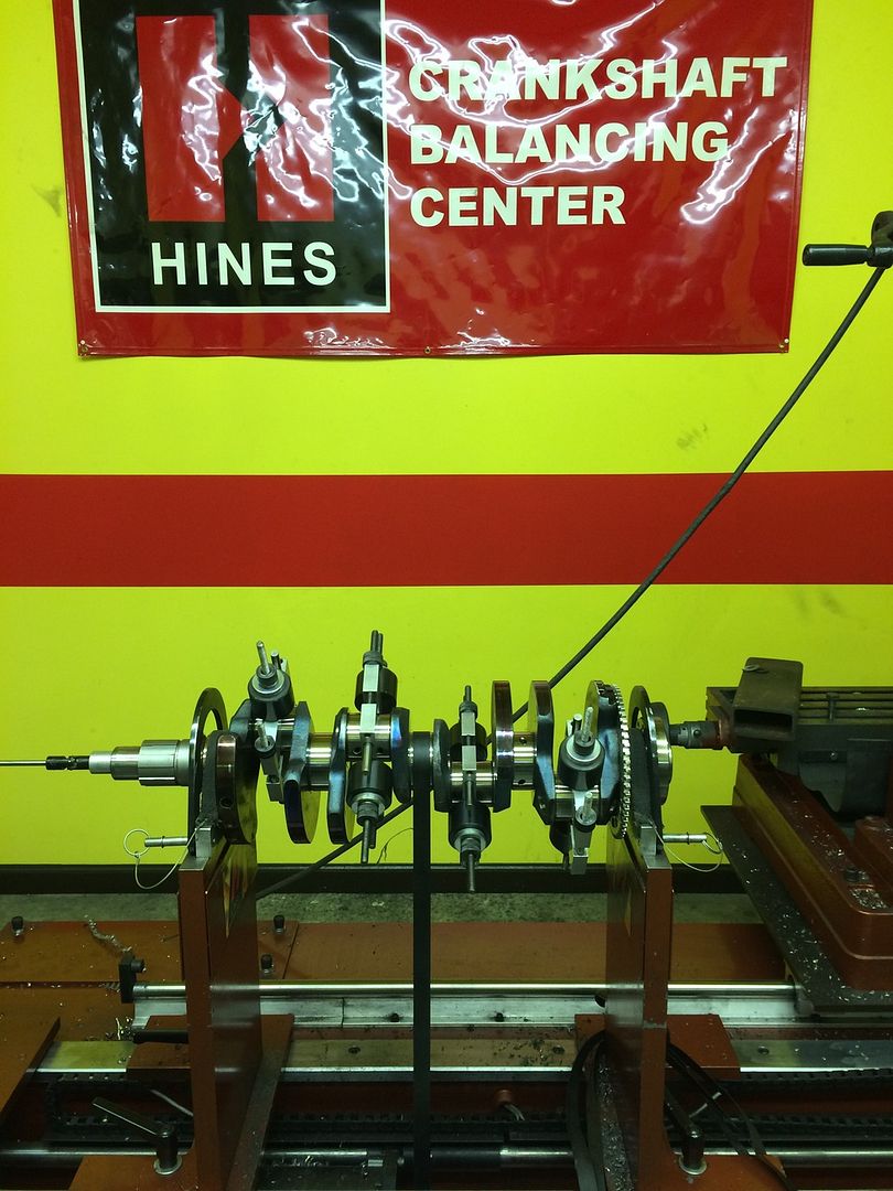

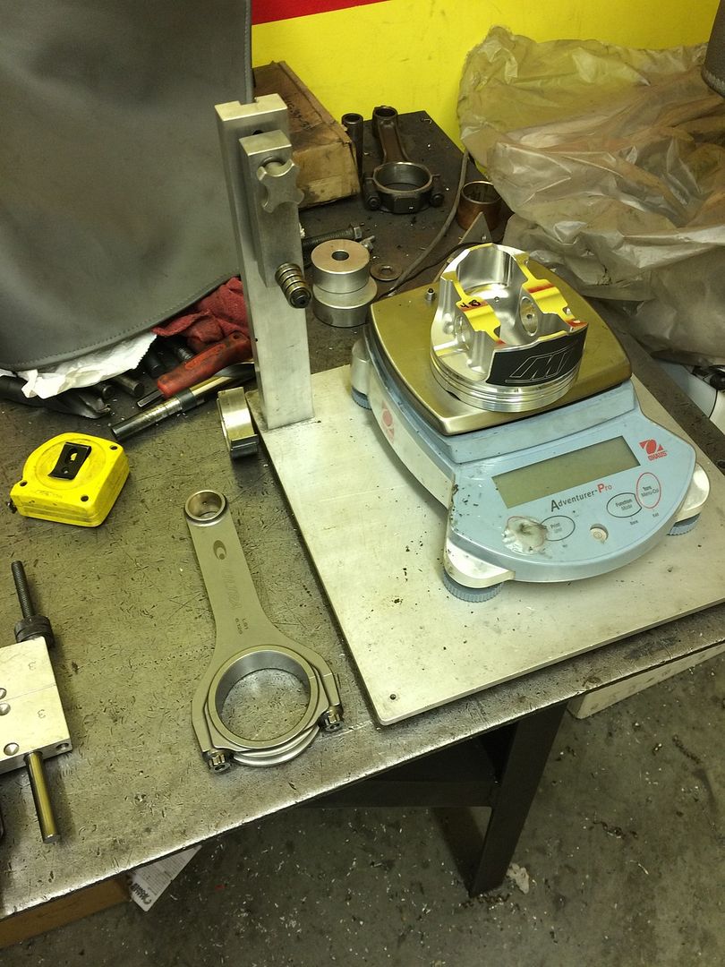

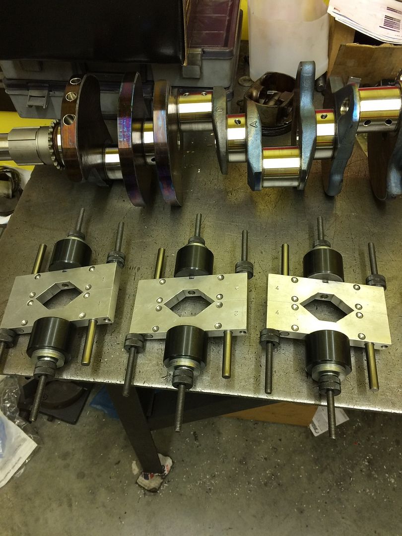

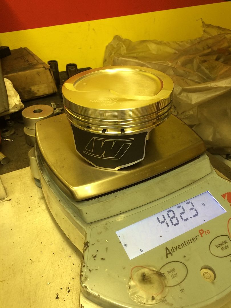

Jim, Here are a few pics of my Balancing Room:
An Ls9 from a ZR1 Vette. Had to add 200 grams of tungsten to get it to less than 3 grams of imbalance.
I've balanced numerous V8, V6, Inline 6 and 4's.
But never a Triple.
I know that the slots aren't for balancing but, it does change the rotating weight.
