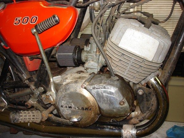

I wasn't going to do a resto this Winter because we are trying to sell the house and this Winter was suppose to be devoted to working on the house. As fate would have it a member of the NE Dirtbikes site, Oldschool, AKA Tom, came across this H1B. He had a buddy who is a tree cutter and cut some trees for a guy who had no cash but had this bike in his basement. The guy asked Tom if he knew anybody who would give him some cash for it and that's where I came in. Some barn fresh pics,
Near as I can figure this bike has not seen the road since 78 or 79.

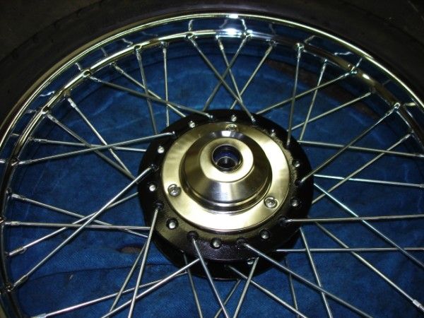

And after, with a new DID rim, bearings, spokes, tube and tire. The front got the same treatment except with paint instead of sand and polish.
I had this dust cover from a group parts but lying around so that went on the front along with new bolts and lock washers for the disc.

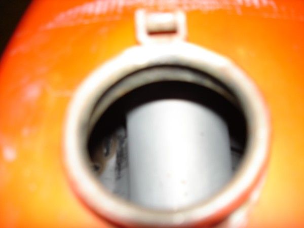

The tank was surprisingly clean on this bike but I stll lined it anyway. I use the Caswell kit and have had great results. I can't see going the work and expense of a full reastoration without it.

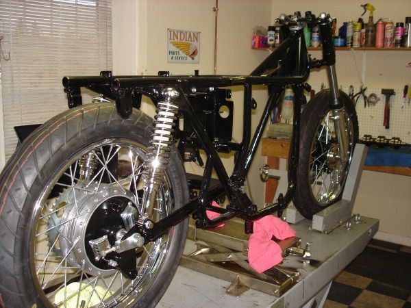

So with some reproduction shocks that got us to a rolling chassis.

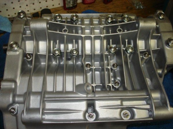

Then it's off to the engine. A before and after of the cases. I know there is more than 1 way to skin a Cat and there is some difference of opinion on this but I bead blast them with a super fine bead. This means lots of cleaning in the parts cleaner tank prior and some Dremel wire brush to get the stuff that just don't want to leave it's comfy 40 year old home in the cracks. The fine bead does not seem to pick up fingerprints and other crap after cleaning either.

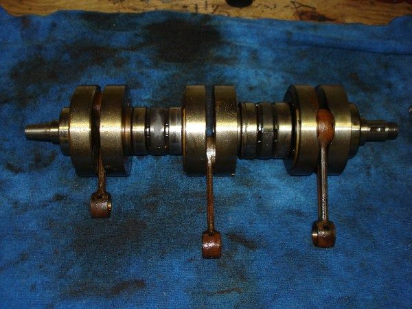

The crank came out and was in very good shape.

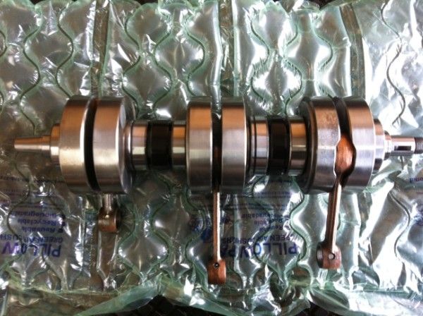

It came back from Dave Singleton looking great!

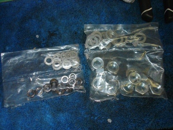

A nice touch is the new Case Nuts and Washers. Though few will see them I think they are a great detail.

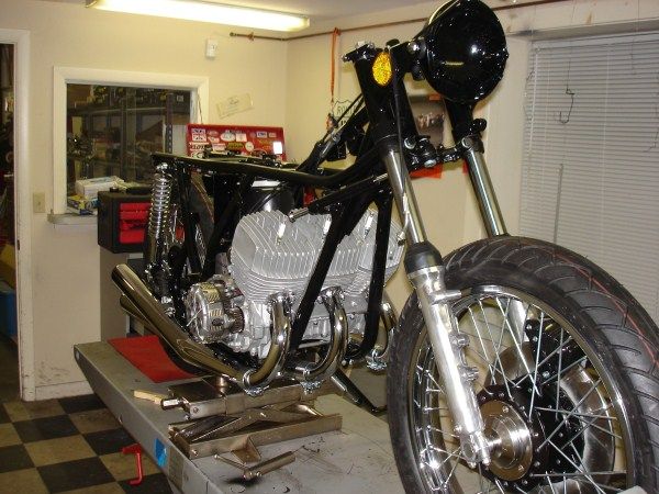

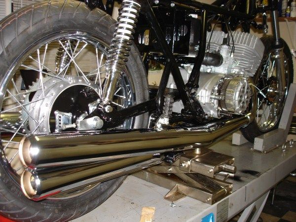

The motor in the frame with the new reproduction pipes. I love a stock look and these pipes really bring it home, if only I didn't have to have the Wife work nights for them.
