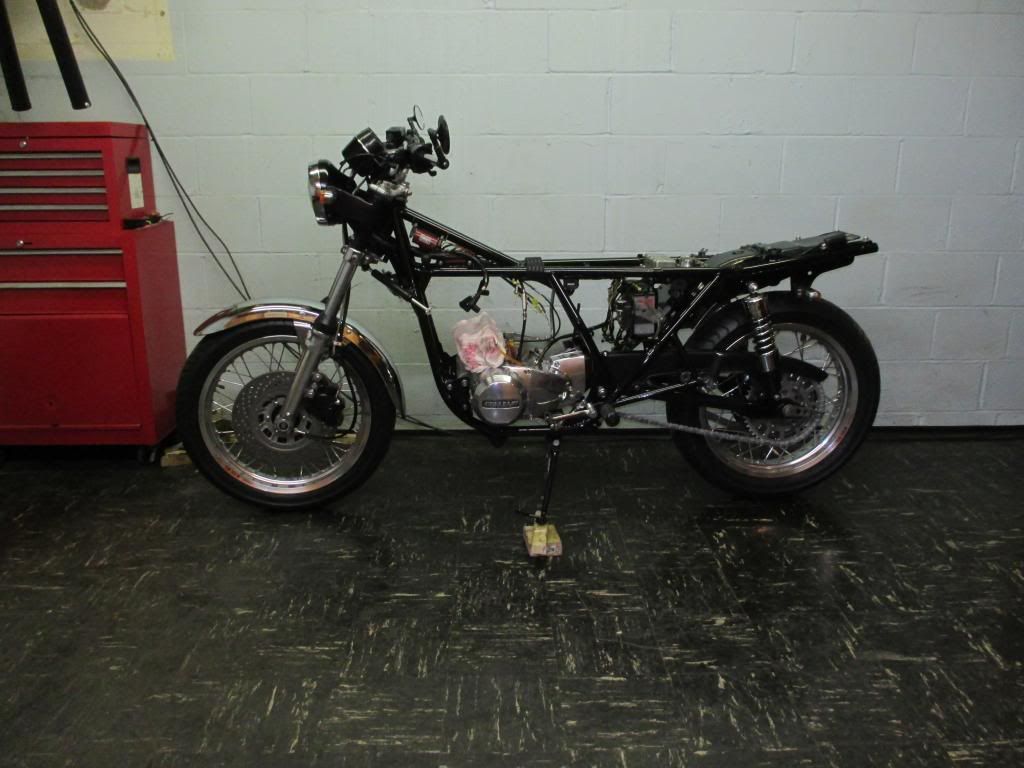

I went up and bought a new camera yesterday and finally have some PIC's of the Bike
I wish to thank all of you for the good advice, lots of tips, tricks and direction, could not have got this far in 12 weeks without you guys !!!

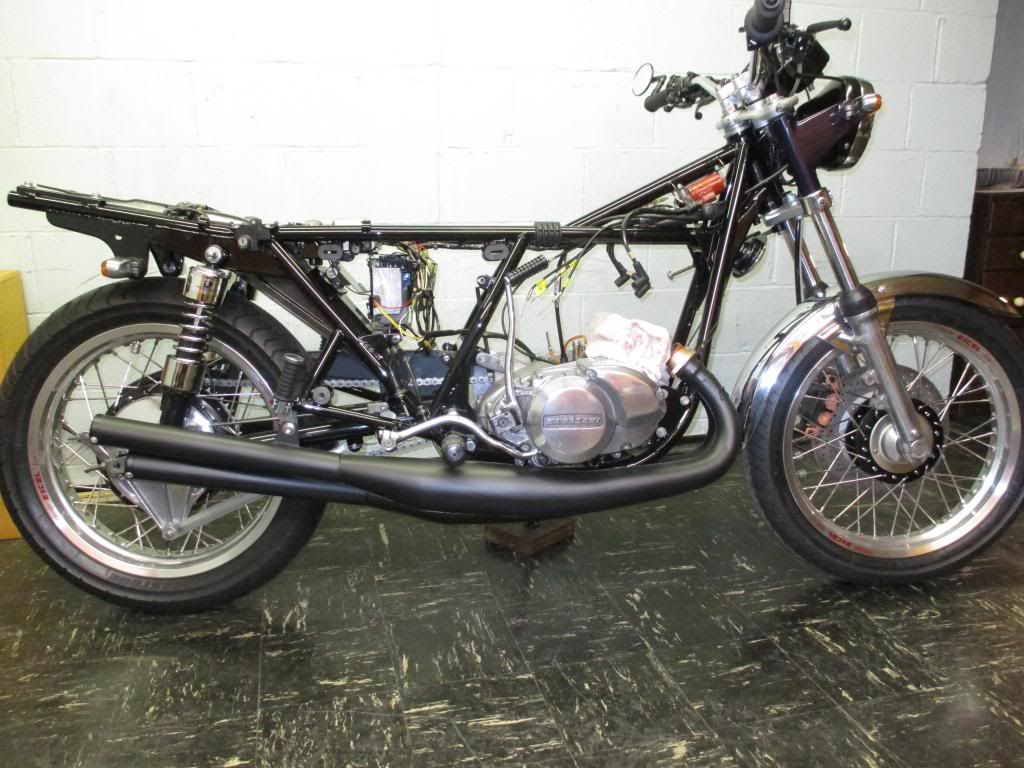

Frame has been powder coated gloss black, other bits satin black, all new wheel bearings (All Balls), steering head, bronze swingarm bushings, electrical re-wrapped, muh converted to stainless or regular allen screws, PBI 520 "X" ring chain conversion, Fat Excell Rims from Buchanons with Polished Stainless Spokes, Bridgestone BT45V tires, EX caliper and Master Cylinder, Moo bracket Plate from Jim, EX clutch Perch, Speigler Line, Drilled PHR racing rotor, HVCcycle did the forks, new tubes from Franks, Racetech Springs, Gold Valve Emulators, 15w oil and ready to go ( Polished the on a buffer), Don Fulsang Gauges, JRD shifter Bushings.........soon to be MOO cylinders........and my buddy Doug Neef has the body work done (fork ears are purple, had no choice).......I have the 75 tank so it will be 75 candy purple from WFO Custom Paint, VM34's are ready (had to carve on the UFO's to get the slides to close for proper idle).......300 hours maybe and a lot of $
:mrgreen:
THX Phil

Excell back 3.50X18 is REWM61840 $260
Excell front 2.50X18 is REWM41840 $218
Buchanans in LA, Laced up with polished SS spokes about $1000 to $1100 less shipping, they are pretty fast too, had them back quick
Then Dennis Kirk has tires, theses are "V" 149mph rated
Back BT45V 140/70-18 072818 $121.97
Front BT45V 110/80-18 072478 $105.97 free shipping
Everything is a real close fit, I would not go any bigger unless planning on some serious mods
On the Back.........did the skinnier 520 chain conversion (530 may work fine) I had to grind an area in the chain gaurd to match and not hit my Progressive 412 shocks as they were pushing it into the tire..........put a very slight bend about 4" back on the brake arm (on the swingarm front end)........put some spacers in the brake bolt\nut.........had to get rid of the lockwasher, pinned and locktighted it...........had to modify the emgo turn signals and space them out, else the tire would have hit them.
On the front........I took the fender mount off and drilled new holes exactly 3/4" center to center above the existing four mounting holes......also, had to get allen cap screws to mount them to the forks as the stock ones hit the rib of the tire when installing.
They look good I think
PS:...are you happy with your jetting on your UFO'd 72........I think I am going to get the needle jets you suggested (P-2 maybe, will have to re-read the VM34-UFO Doc, have P-6 now)
THX Phil

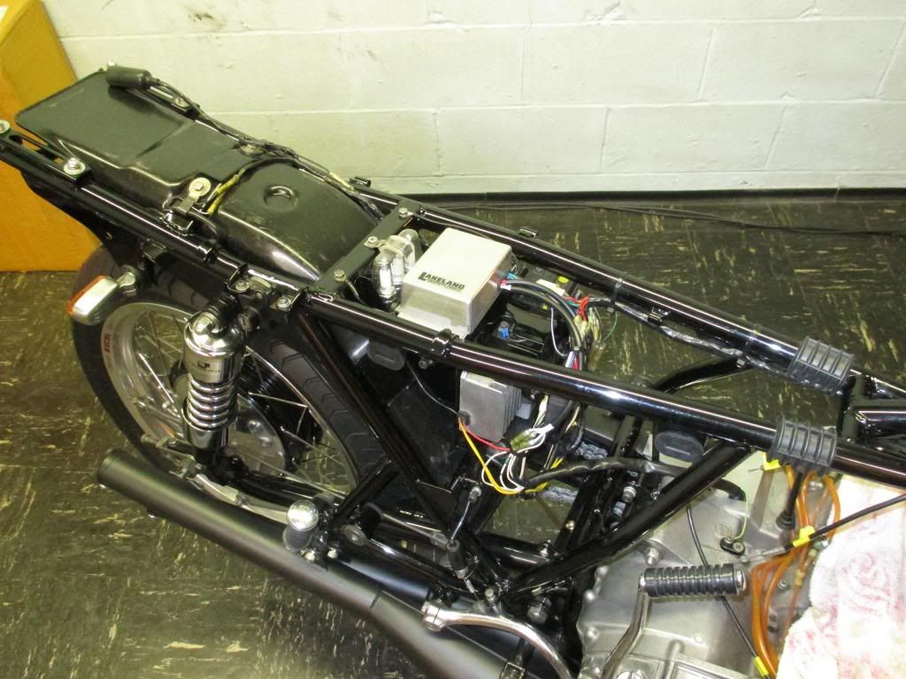

Yes, I am showing off :mrgreen: ...........Jims new CDI box (Thanks Jim !)..........way cool.............I thought my buddy's were going to have a Gorebasm when they saw it...........the nasty old CDI box had to go.
