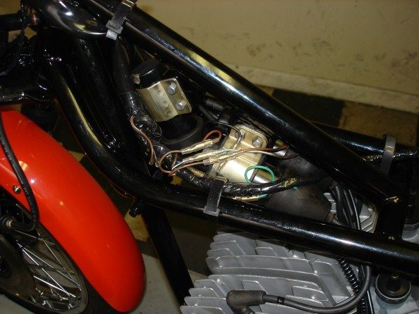

A wiring harness pic here. I admit I cheated on this one because nobody sees it, but I still wanted a clean look. The OEM coil mounts were Yellow Chromate but I didn't want to go thru the plating process and then Chromate. I ended up wire wheeling them clean and then Yellow Chromate, which came out just fine. Connectors were replaced and the rubber boots got the Back to Black treatment.Turns out I think I found out why this bike got parked back in the late 70's. The center cylinder coil wires had chafed thru against the clutch cable and the center cylinder must have stopped firing. Simple fix but it was probably one of those deals where the bike gets parked with all good intentions of getting to it and 35 years go by.

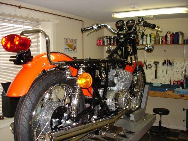

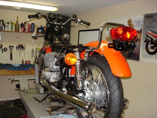

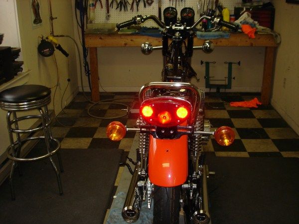

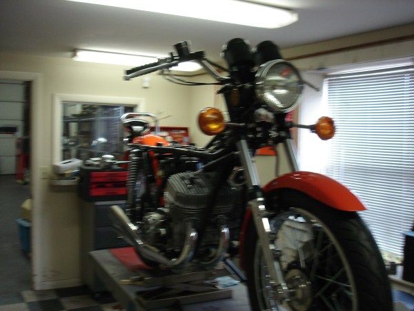

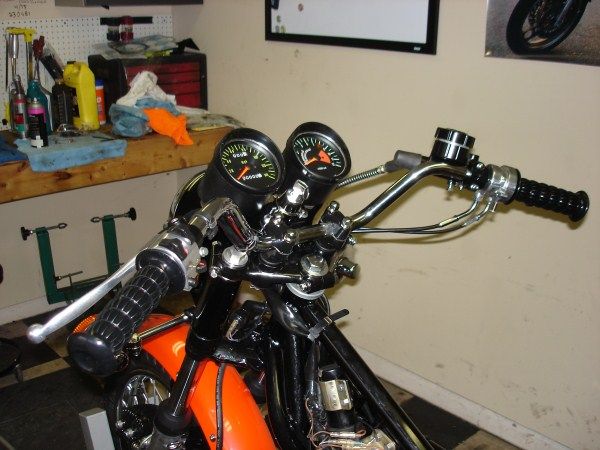

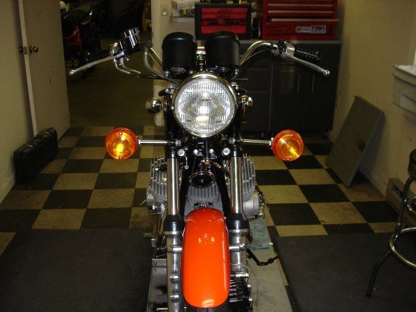

A few pics of how she sits now. All lights, horn, etc. work. All three plugs spark so this bike is getting close to blowing smoke. I will be traveling next weekend but the time table looks good for Deals Gap in the beginning of May.

PostPosted: Mon Mar 17, 2014 11:07 am
That looks fantastic! Points are a pain...but they almost never leave you stranded!
 Post subject: Re: 72 H1B Restoration
PostPosted: Mon Mar 17, 2014 12:12 pm
i like it ,i dont seem to see many of those being restored as nice as that :thumbup:
PostPosted: Mon Mar 17, 2014 6:54 pm
I think the orange '72 is the best looking of all the 500's. That's a great job, I can't wait to get started on one of mine.
PostPosted: Tue Mar 18, 2014 4:41 am
Posts: 797
Looking VERY good :clap: :clap: :clap:
(Seeing this, I am so glad I have a H1B myself)
Jorgen

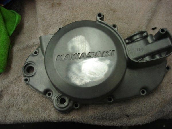

Back at it again this weekend. I had family obligations so not as much as I would have liked got done. I guess I could have snuck out early. "Hey Mom, I know it's your birthday but I got a build coming together". This weekend was a dirty one cleaning and polishing cases. A thankless dirty job that I never look forward to. My procedure for polishing these cases was first cleaned in the parts washer, then bead blasted, then scrathes and mars were blended out, re-blasted, sanded to 600 Wet, Tripoli polished on a sewn wheel, and then Jewlers Rouge on an open wheel. Here is a before pic. A buddy stopped by today and saw them before and commented about how crappy they looked.
Here is the clutch side cover after being cleaned, bead blasted, and then having the brake pedal marks and some other scratches blended out with a 2" Medium Scotch Wheel. The marks came completely out. The Points Cover had a nice dig that I didn't know if it would come out completely but it did and you would never know where it was.
And, the after pic.

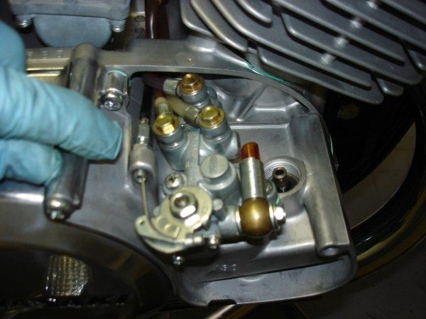

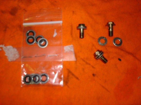

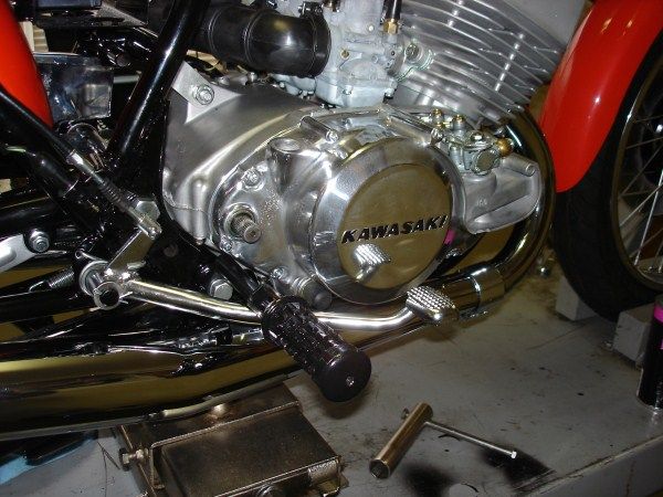

The clutch cover got mounted with oil pump and tach drive. The NOS rear brake pedal got installed with cable, and the foot pegs went on. The Stat O Seals that are used on the oil pump banjo fittings.
When will I learn to put that cable on BEFORE the pump goes on.
If I can get NOS it is usually ends up just as expensive as a rechrome but you don't have the lead time. The brake lever and shift lever are NOS. The K/Start is still in good shape and will be reused.
