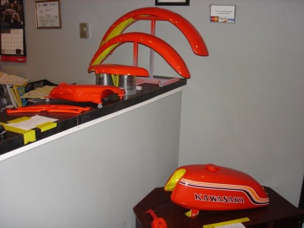

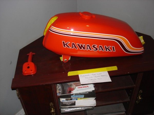

Some pics of the paint that I will pick up this afternoon. Fellow CT Rambler Larry Kilgore did a fantastic job. Larry rides Orange off road too and likes the color.

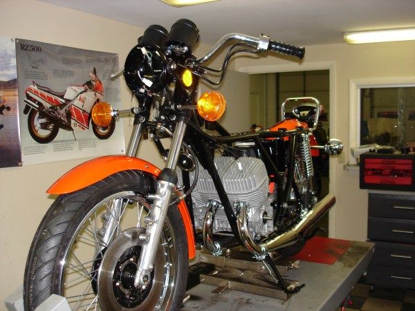

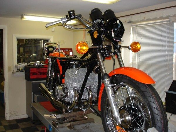

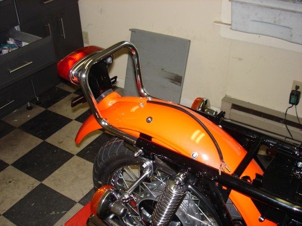

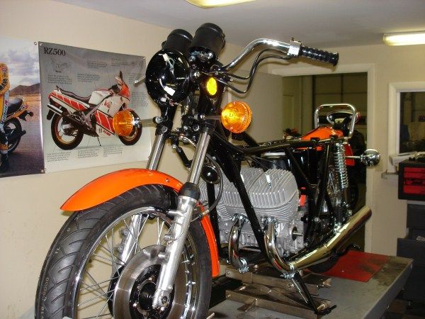

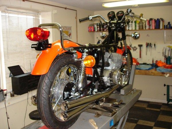

This was one of those weekends where a lot got done but there just didn't seem to be enough time. This is my favorite part of a project, when it all starts coming together. You don't want to leave the shop. First up are pics of where the bike is at. Fenders are mounted, tail light on, meters and bars on, front brake almost complete, more on that in a sec.

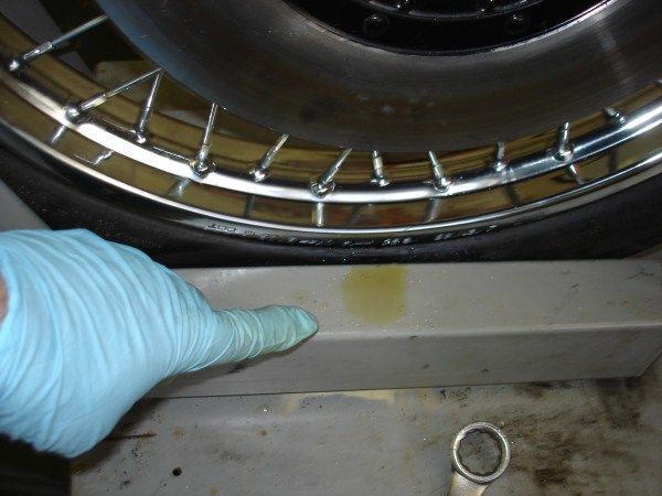

I really can't bitch about set backs on this project so something had to be expected. After getting all the front brake components together, and this is the bitch, BLED! I saw this under the caliper. As I was telling a friend, if you don't like doing things more than once, and sometimes a few times, restoring old bikes may not be for you. The original kit I used to rebuild the caliper was Kawasaki components. I have ordered another brand and will try again. When I tore it apart there was no obvious seal tear or anything.
