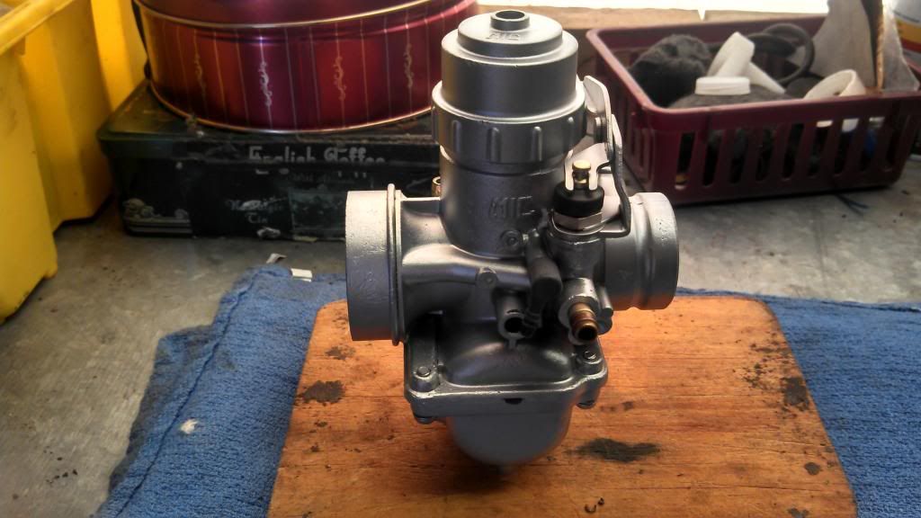

Did some carb bead blasting today , almost done with them. I will be at the House of Haase next Sunday with all my parts and we will have a runner when we are done :D

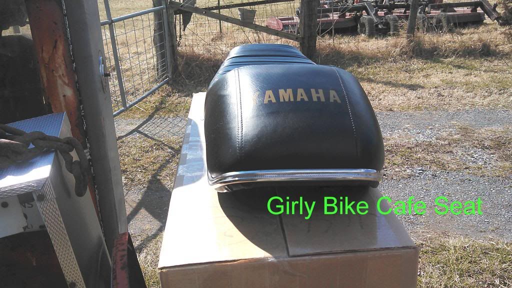

Took the seat out for a little time in the sun:
LH carb almost done:
6 days to finish the rest, still have to change the fork oil in my forks and do a thorough clean of the carbs. I also have to rebuild the petcock on my parts bike tank for the initial run up. The tank on the bike will get cleaned and Caswell coated before the Gap.
