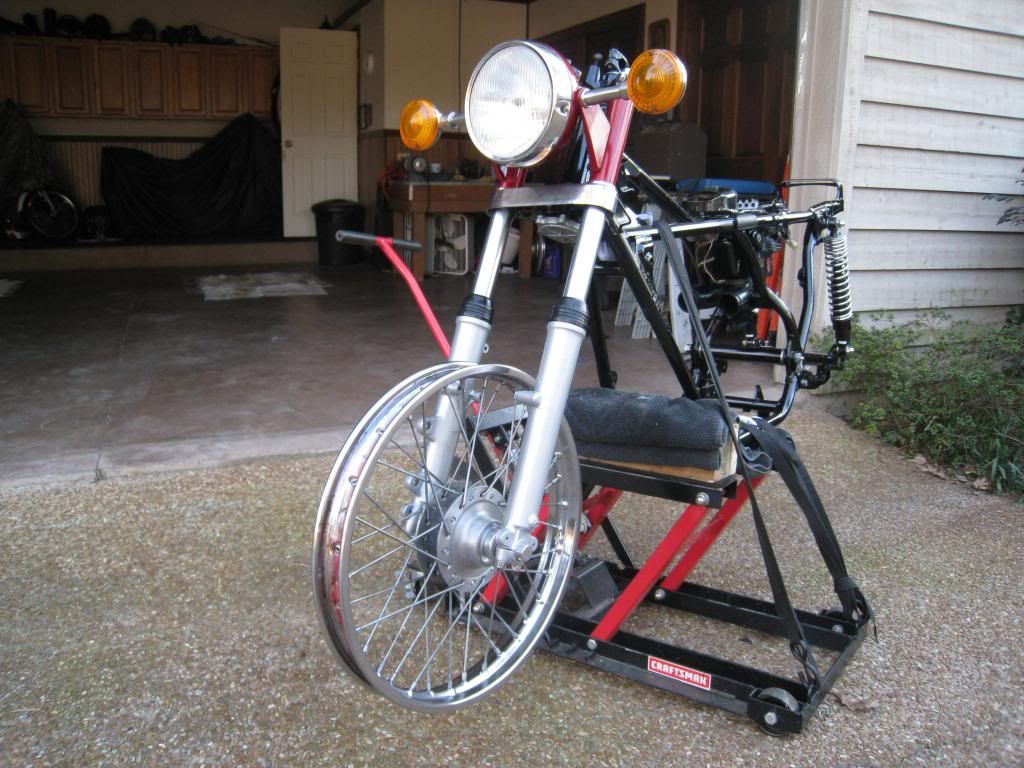

Here is my progress this weekend.

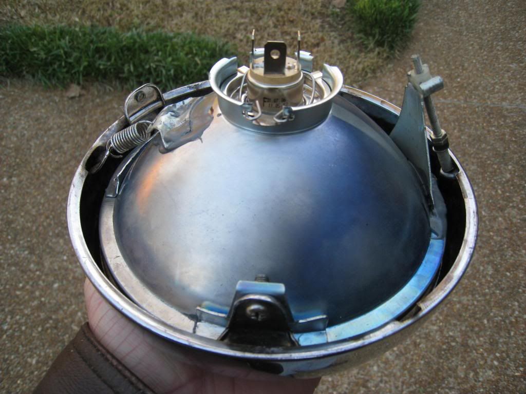

Head light upgrade to halogen. I removed the brackets on the OEM seal beam unit and JB'd them to the upgraded unit. I'm still not to going ride after dark if I can help it.
I removed the spokes to derust them, relaced the rim, and trued the wheel to within about .025 run out both vertically and side to side. The shop manual says to be within .070! This was the first time I've done this, do you think the .025 is good enough?

I would assume so john, but I have never laced one. I think I read somewhere that the stock headlight is about all the charging system can handle... Enlighten me :? :?
PostPosted: Wed Feb 20, 2013 7:16 am
^Tim, The charging system is maxed out on both the RD350 and RD400. The H4 upgrades come with a 60/55 watt lamp. You must replace the 55 watt lamp with a 35 watt H4 or.the battery will be discharged as you ride. Once the battery voltage gets low the engine will die when the rpm's gets too low. During my tear down I also found an electrical gizmo behind the steering head. I wondered what the heck is this? I found it is a thermal relay that flashes the stop light indicator on the instrument panel if the brake lamp burns out. If you try to run a LED tail lamp the relay will flash the indicator because of the reduced current.
By the way the spoke lacing requires you to have the correct attitude. It reminded me of working on a cross word puzzle. You would not want to pay me per hour to lace you rim! I'm afraid the spokes will just re-rust so maybe stainless spokes will be in its future.

Cool, thanks for the info. I am almost ready to go to Rock Hill to hear mine run and bring it home for Gap prep. Work and other crap keeps impeding my progress. I will be working on them all the day before I leave as ususal...

Polishing spokes just removes the protective zink coating, so it's rust city......
I think the existing rust had eaten the zink already anyway :) It was good pratice so when I have the cash to buy SS spokes I'll know what I'm in for.

PostPosted: Wed Feb 20, 2013 5:58 pm
um.. you can run a 55 watt halogen on a stock system no problem. heck, i ran a stock system w/ a halogen, electric waterpump, and an allison ignition on the 'wagon. stock rotor/stator. no issues.
that being said.. you can use an led for the tailight, and led's for the gauge lights.. you just saved about 30-35 watts of draw on the system.
just sayin. :wave:
PostPosted: Wed Feb 20, 2013 7:05 pm
m in sc wrote:
just sayin. :wave:
Mark, I believe the RD350 uses a 8 watt tail lamp and (4) 3 watt gauge lamps for a total savings of only 20 watts if you unplug them. If you run on the 60 watt high beam along with it's high beam indicator like I have done before by accident-the battery will drain-at least it did on my 400. I've often wondered how in the world you got by running the water pump? :) Do you know what the stock charging system capacity is?
