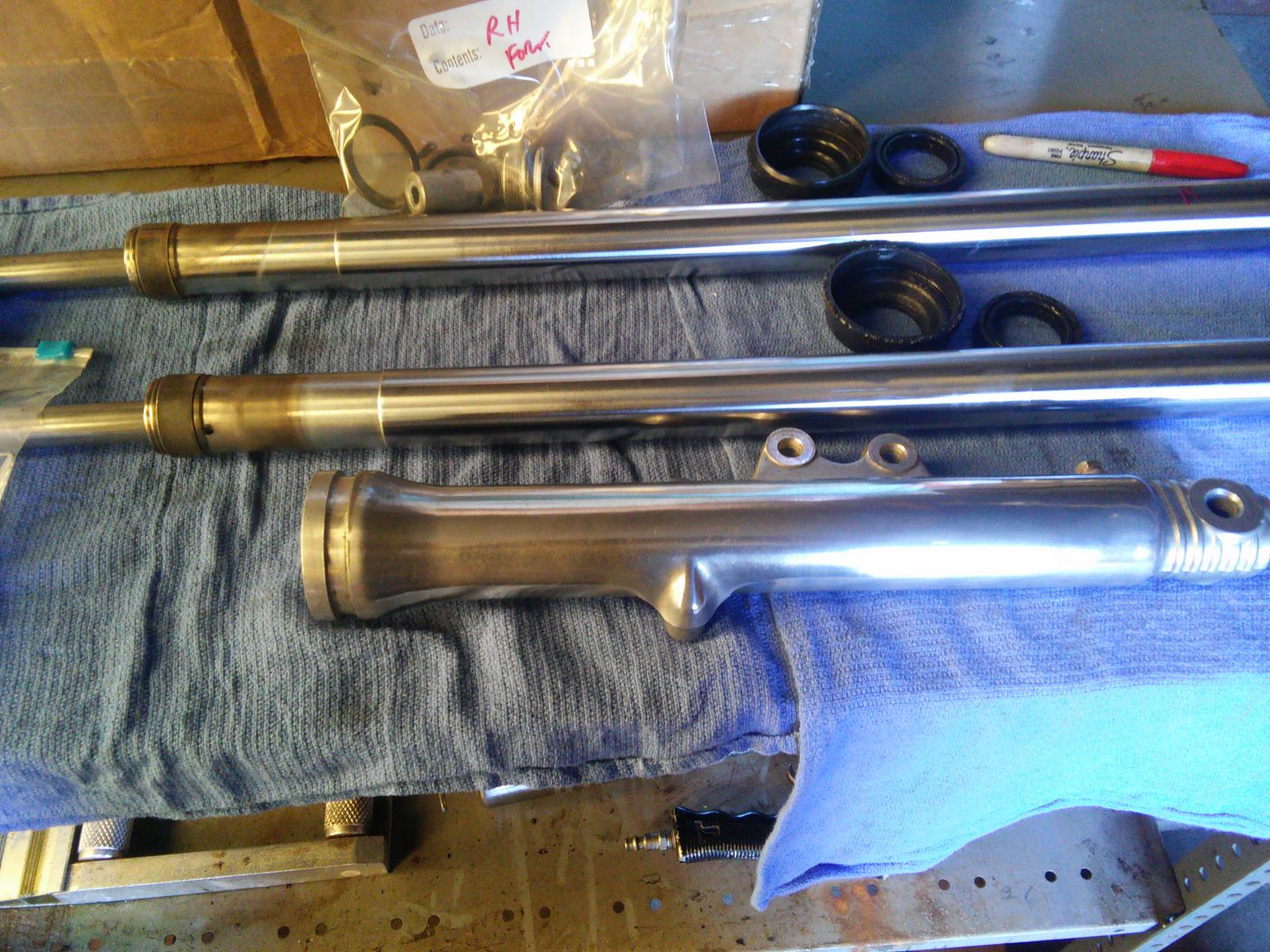

Found a nice John Deere bearing and sleeve now utilized for driving the upper bushing into place. They now reside in thier new home in my fork seal driver kit. These forks are a PITA to change the seals on. You have to assemble them 1st then drive in the bushing and then some hardware, then the seal and retaining ring....
PostPosted: Mon Nov 23, 2015 3:42 pm
8.5 ozs per fork leg of good old type f.
PostPosted: Mon Nov 23, 2015 3:44 pm
My high tech fork filler....
PostPosted: Mon Nov 23, 2015 3:48 pm
New seals, new boots, new Progressive Suspensions Springs, cleaned inside and out. Polished lowers. Forks done!!! :D :D

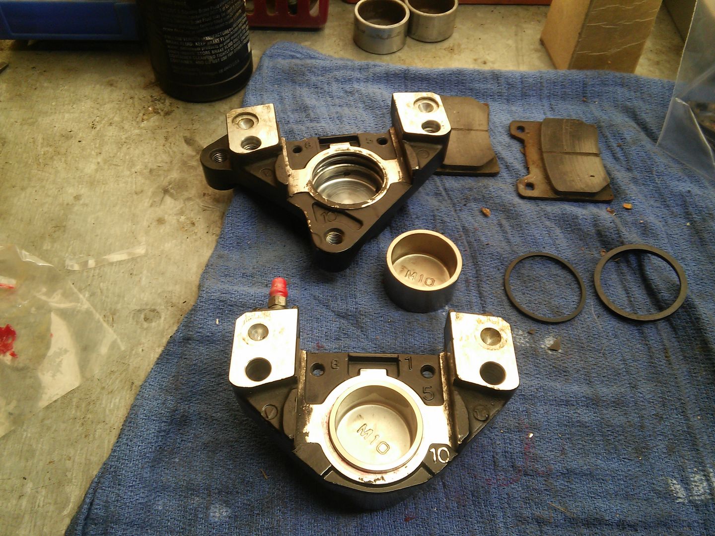

Tommmorow's plan before work is to reinstall the front fender and wheel and begin building the 3 calipers after I check my Baby Mommas.....
PostPosted: Tue Nov 24, 2015 2:42 pm
Todays progress:Image
New pistons and seals installed. New pads installed.

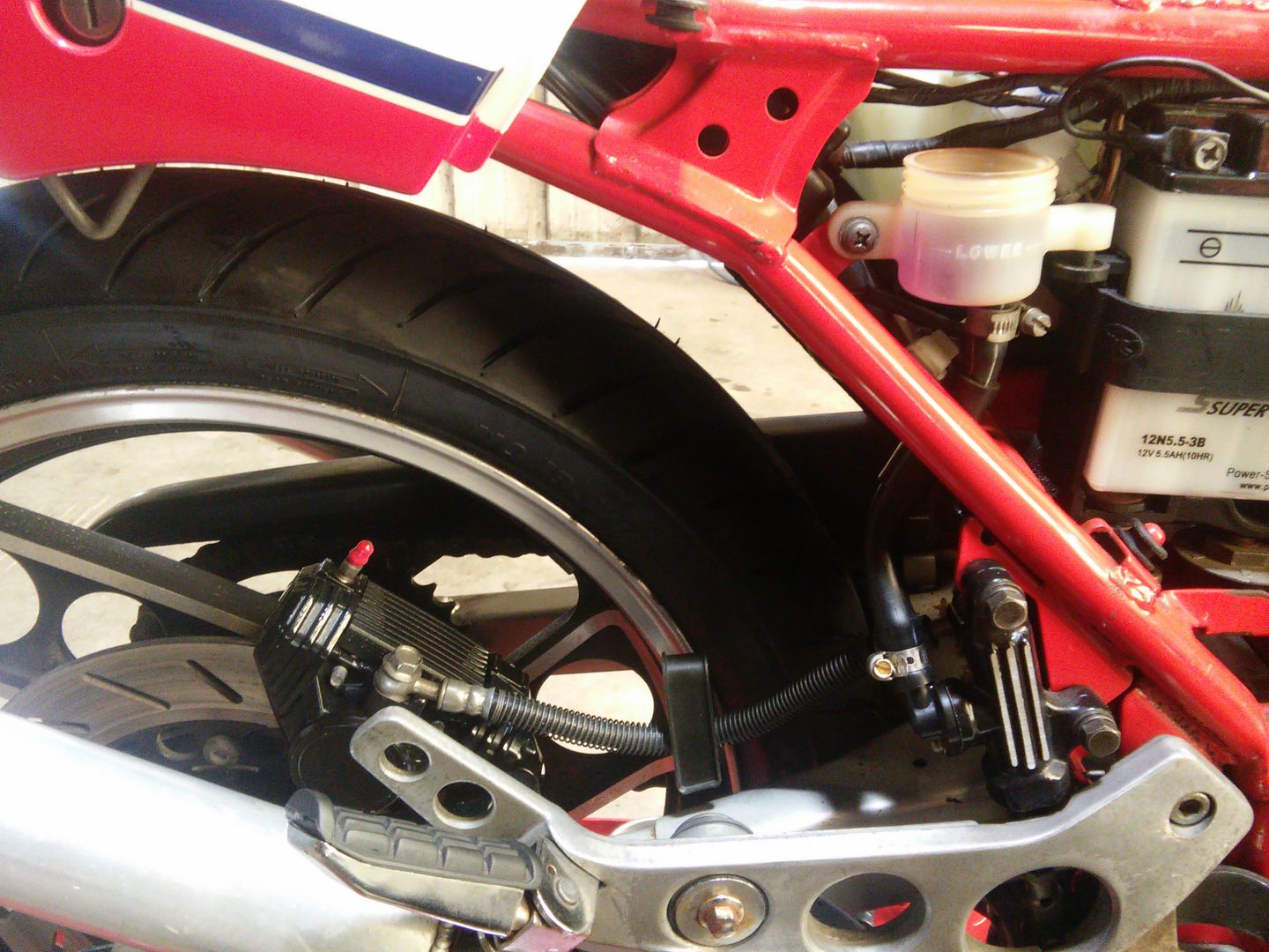

Rear caliper built
Installed and bled (for the most part) lever tied down to burp last of air out. Keep fingers crossed no leaks and no dragging so far....DOT 5 silicone brake fluid is my preference, Advance Auto Parts finest.
