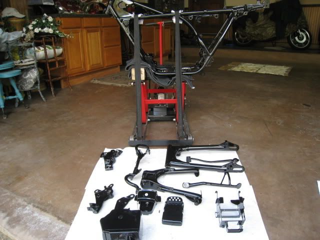

Parts back from the powder coater. :D

Gonna be very nice. You had play with your swing arm bushing? I havn't gotten to mine at this point.

While the bike is on the center stand try to move the rear wheel side to side and see how much movement you get. The RD's use nonmetallic bushings in the swing arm. I replaced mine with bronze bushings. The bronze bushings will need about .005 taken off their OD's. See my last post in Barry's toolbox thread. I also have installed new rear shocks as well. This should help the girl haul my lard butt around. You may need to do the same :D

actually, some (most) use plastic? bushings, some dont. i havent figured out which ones do or dont, but there are some that came with steel bushings. weird, i know but i have taken down original survivors that had them.

When I pulled the swing arm shaft on my Daytona the bushings were nonmetallic and fell out in pieces. When I pulled the 350's shaft I could tell the bushings still fit good and were gray so I thought they were steel. I was wrong they also are nonmetallic. I think the clearance i had was too much end play and all I probably needed to do was tighten up the swing arm nuts. I done bought bronze bushings so they are going in.
