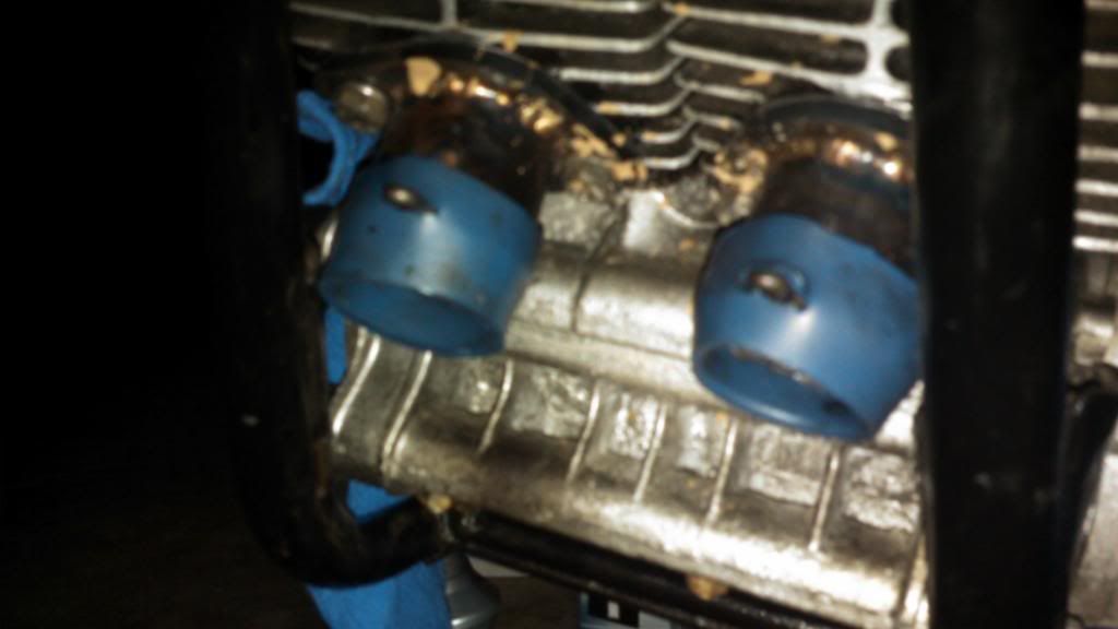

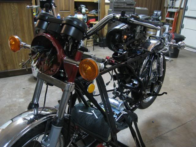

Chamber condoms installed , troubleshooting turn signals inop, disassembly continues...
PostPosted: Sat Mar 23, 2013 11:38 pm
Good Saturday in the girlie garage :) I love days like this after a week of regular work.
Got the electrical installed and checked out. Tim the chocolate brown and brown wires are hard to tell apart after 40 years. I had to trace them out to get the circuits correct. That may be your issue with the signals.

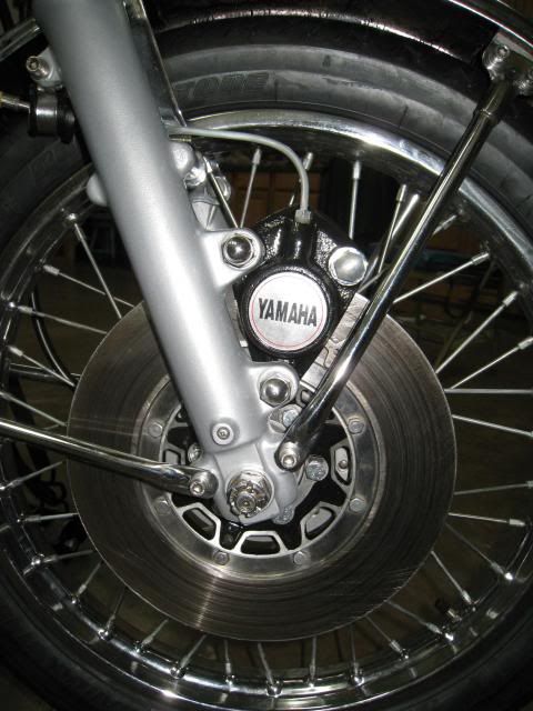

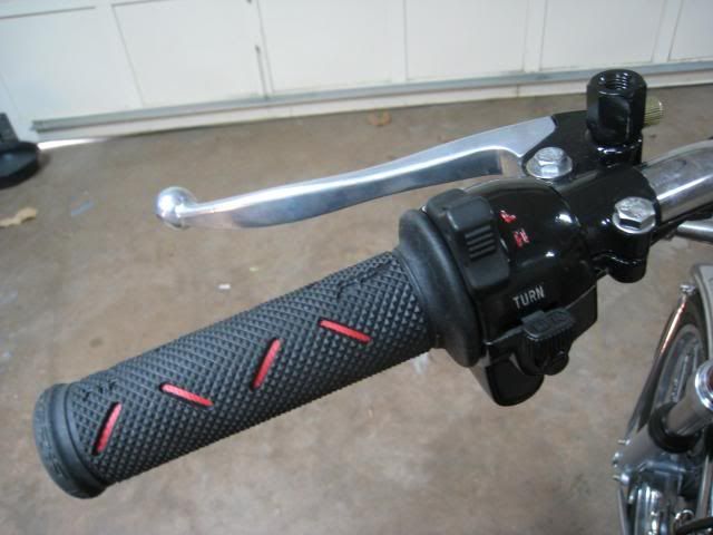

Front brake installed and bled out :!: Nice firm lever...just like I like :thumbup:

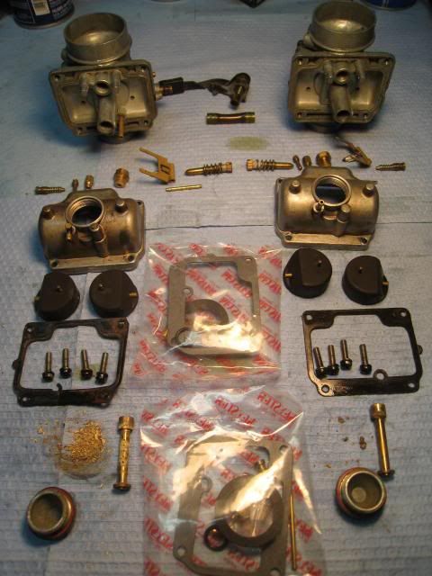

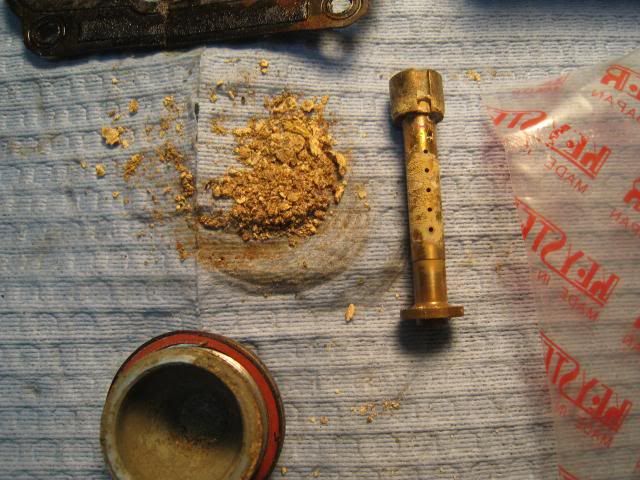

Check out this left needle jet :o and I rode this across the Cherohala last year :wtf:
Carbs on Sunday after church. :D

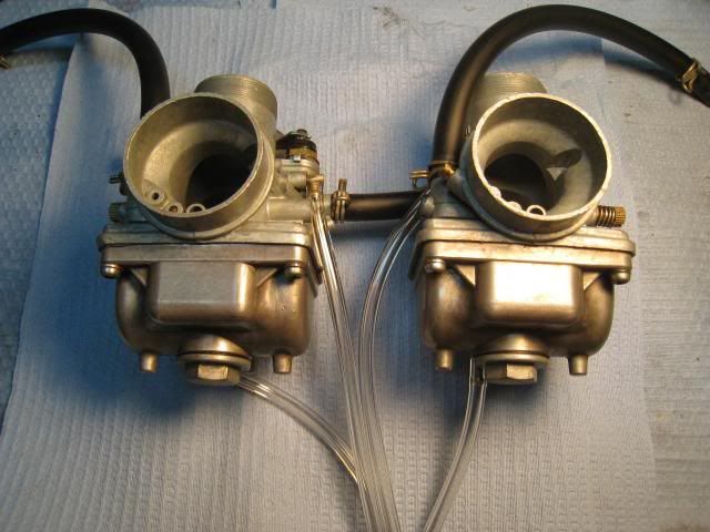

Carbs done.

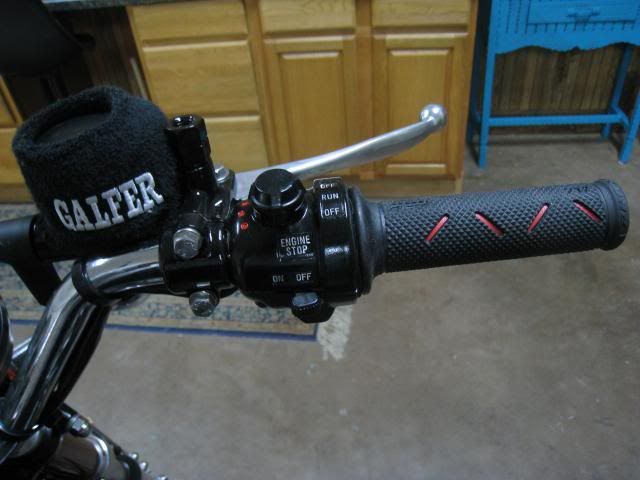

Controls done.

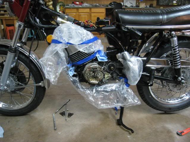

Engine going in. You have turn the engine to a 45 degree angle, put it in and then rotate it back. What a pain.

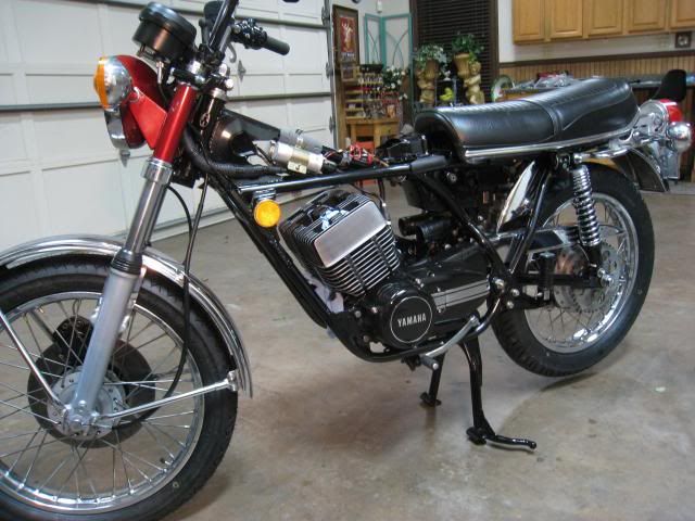

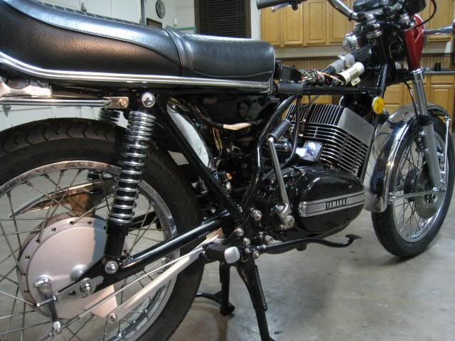

Her profiles :D :D :D

rust or dust on neddle jets is very commun on Yamaha twin 2 stroke, don't know why but got a nice hole on a piston on the Yamaha RD 350 air coled on the girl from this time on the middle of seventies when we went to Norway, were already in Belgium, changed the piston on the road and cleaned the neddle jets and arrived in Norway two days after.
