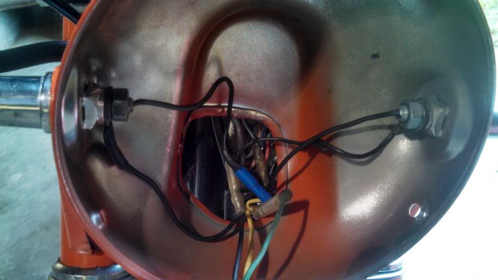

John,
How did you get all the wires from the headlight bucket to fit in the new one from Economy. Most of mine ended up outside the bucket because the hole n the new bucket is in the bottom, not the top or middle like the factory bucket? Most of mine ended up on the outside of the bucket between the LH headight ear and the bucket plus I had to make 2 pigtails as the turn signal power wires would not reach? The other gob of wires is stretched VERY tight and rubs against all kind of stuff if I try to cram it all inside and it is too short.The Blingmaster said to drill another hole, but the bucket has a hell of a big hole in it already?
Gob O' wires
I hate electrical stuff :banghead :banghead
PostPosted: Mon Aug 05, 2013 12:18 pm
Sorry Tim but you need to figure out how to fill the hole.
