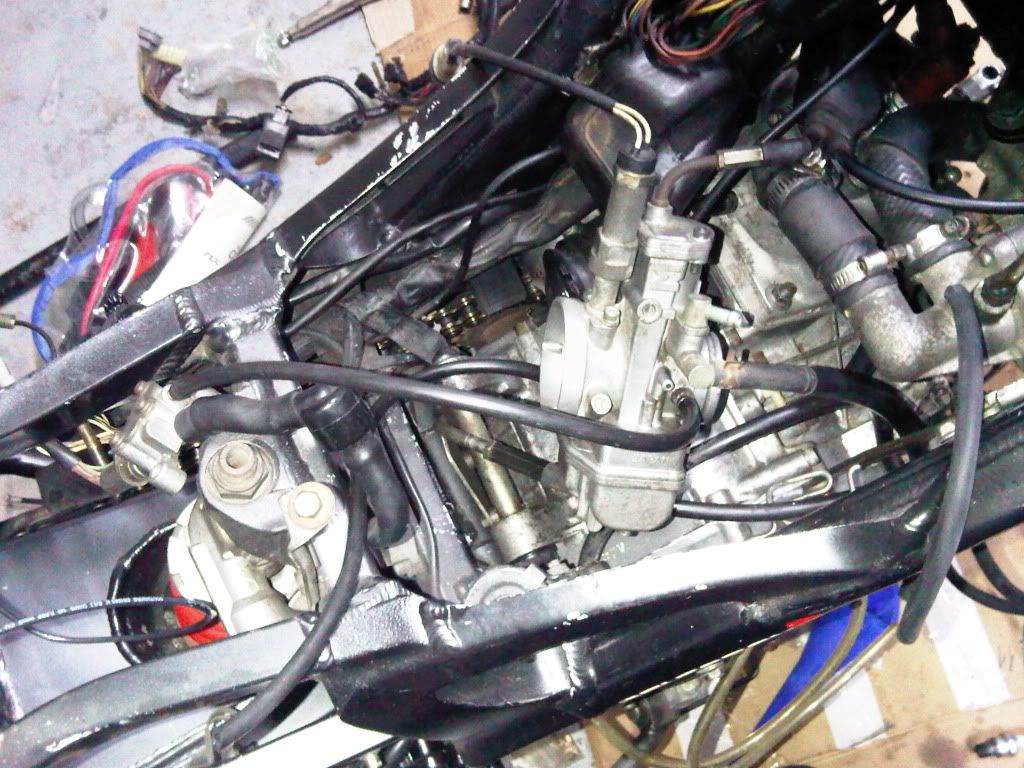

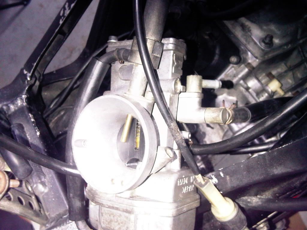

The powerjet carbs for the TZ/TZR type Yamaha's look like these below and are electronically controlled...
I picked up a 92 3XVR model project a few months ago. Have it about all sorted and road worthy. Can't wait to go ripping around with it!
92 NSR250 MC21, 93 TZR250 3XV
03 ZRX 1200R

evansje1 wrote:
What the heck is a powerjet carb? I don't think my RZ has them.
As mentioned in a previous post, Yamaha started using power jet carbs in the early 70's on race machinery. I had a 1978 Yamaha SR-X 440 snowmobile that came with powerjet 34mm Mikuni's. There were 2 jets in the bottoms of each bowl, one main jet and one power jet. cool ! I also had a 1991 Yamaha WR200 enduro dirt bike-- factory Kehin flatslide power jet carb also. Hmm, all this reminds me that my 85 Yamaha RZ500-V4 Has stock power jet carbs, kinda,(26mm Mik's) but the fuel exit holes are not drilled. No, I'm not gonna do it !!!-lol
This dambed bike is complex enough.
